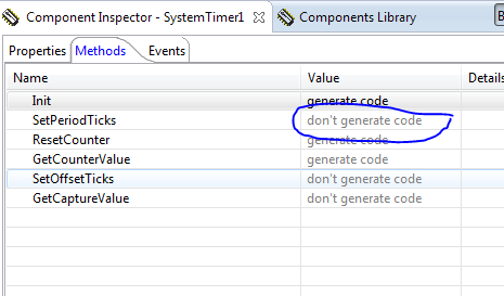

Has anyone experienced difficulties changing the value for SetPeriodTicks to generate code within the SystemTimer1 for MQXLite...?
I'm using PEv10.6 and my target processor is on a TWR-KL25Z48M board.
I've checked Counter restart is set to On-match within properties but the SetPeriodTicks don't generate code is grey'd out.

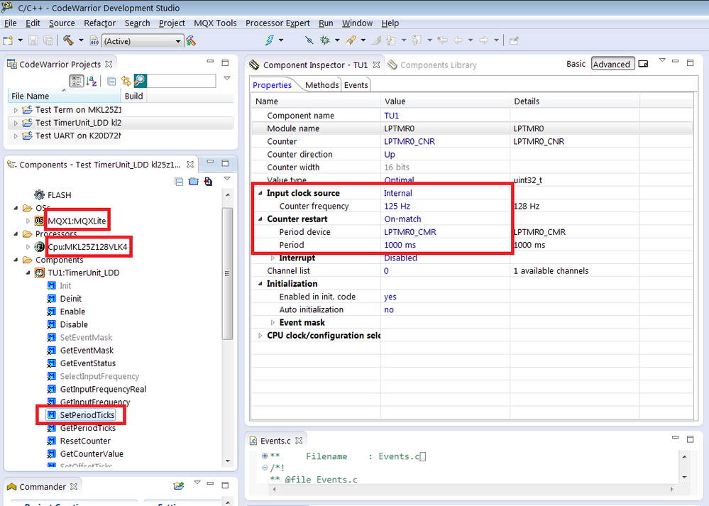

Hello Ken,
I received the answer from PE team ,
" the inherited component TimerUnit_LDD where the SetPeriodTicks is disabled by the MQXLite component's template. The SetPeriodTicks method is not allowed when the TimerUnit_LDD component inherited by MQXLite (this functionality is not supported by the MQXLite component)."
When you new add the component "TimerUnit_LDD " , it can cofiugure the SetPeriodTicks ,

If you use the project wizard to generate a new MQXLite project and go into the SystemTimer1 component and use the component inspector to view the methods - you will see the SetPeriodClicks - "Don't generate code" is greyed out making changing it impossible....
Is this a bug in Processor Expert component or am I missing something..?

Hello Ken,
Alice
