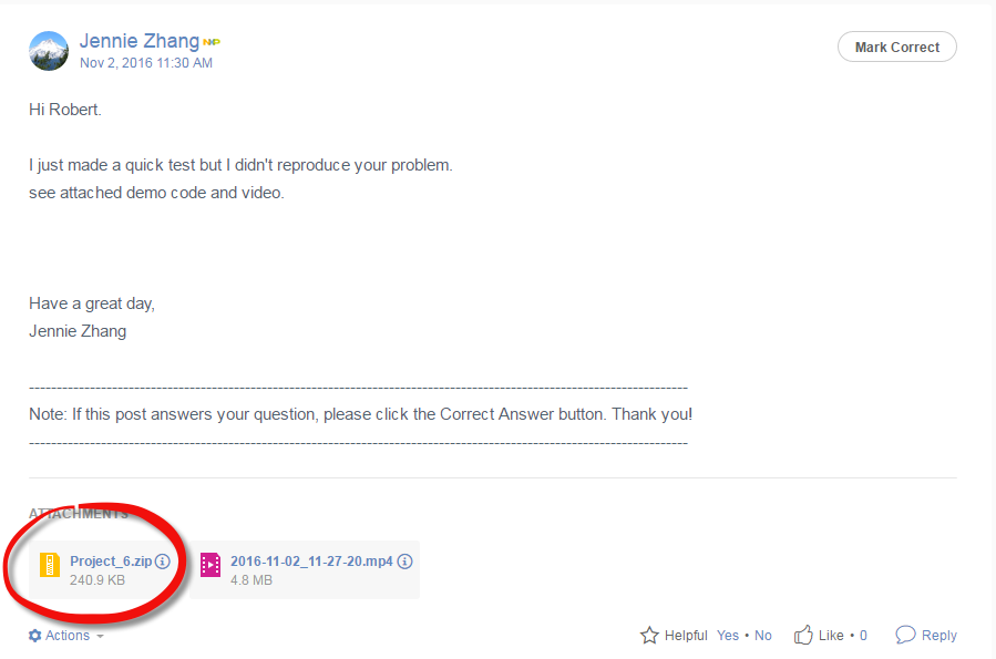

ZhangJennie
Can't you see it?
here is the screenshot of it
4,684 Views
rmaier
Thank you, Jennie. The video was very helpful. I missed some items in the prm file.
Not sure how I missed the video. My appologies.
