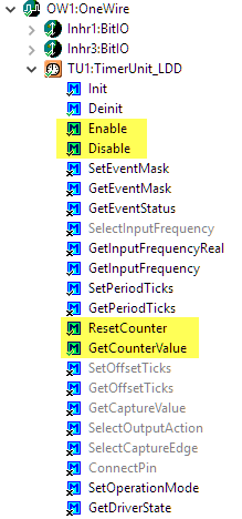

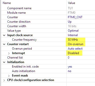

BlackNight
Hi Julian,
use the TimerUnit_LDD:
Enable/Disable starts/stops the counter. ResetCounter is used to set it back to zero, and with GetCounterValue you get the counter register value.
Set your timer frequency with interrupts disabled.
Voilà :-).
I hope this helps,
Erich
