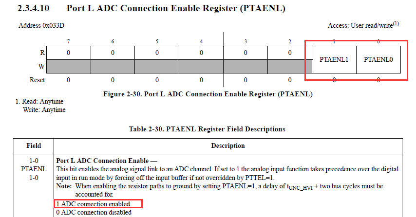

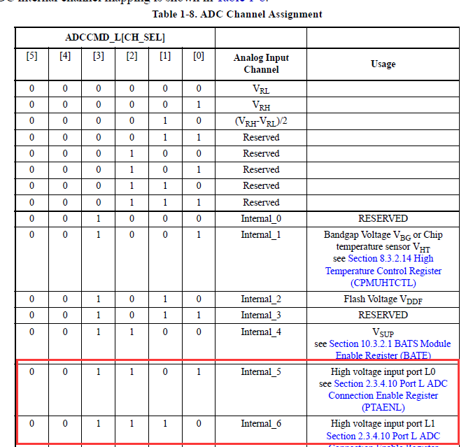

In MC9S12ZVC-Family, how can the  Port L input signals ( PL[1:0] / KWL[1:0] ) can be configured and used as analog inputs during ADC conversion.
Because I couldnt find this port as an Analog input channel select in ADCCMD_1 register.
Can anyone help me to fix this ?
Thanks in advance,
Madhav.
1,427 Views
Hello Madhav,
Please check the MC9S12ZVC-Family Reference Manual :
About the code ,  you can create a project with Processor Expert , then add ADC component ,
choose the the PL0 as ADC channel , generate code, you can refer to these code , I also attached
the Init_ADC file .
Hope it helps
