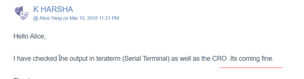

kharsha
Hello Alice,
I have checked the output in teraterm (Serial Terminal) as well as the CRO .Its coming fine.
