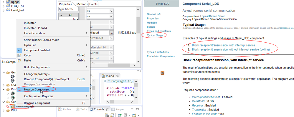

Hello ,
Yes, there is no error in your sending code.
I rememberd you said it can work well :
About the usage of  Serail_LDD, there are demo code you can refer to:
Hope it helps
