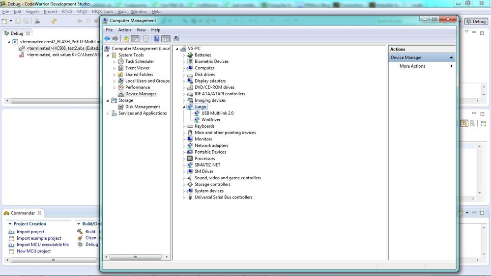

I want to program MC12311 IC which has HCS08QE32 MCU in it, using PE USB Multilink Universal and CodeWarrior 10.5 on a win7-64bit platform.
codewarrior detects Multilink Universal Programmer but fails to connect when erase/debugging mcu.
here are the screenshots of problems:
image 1: the Multilink Universal is detected and installed automatically by windows. (USB Multilink 2.0)

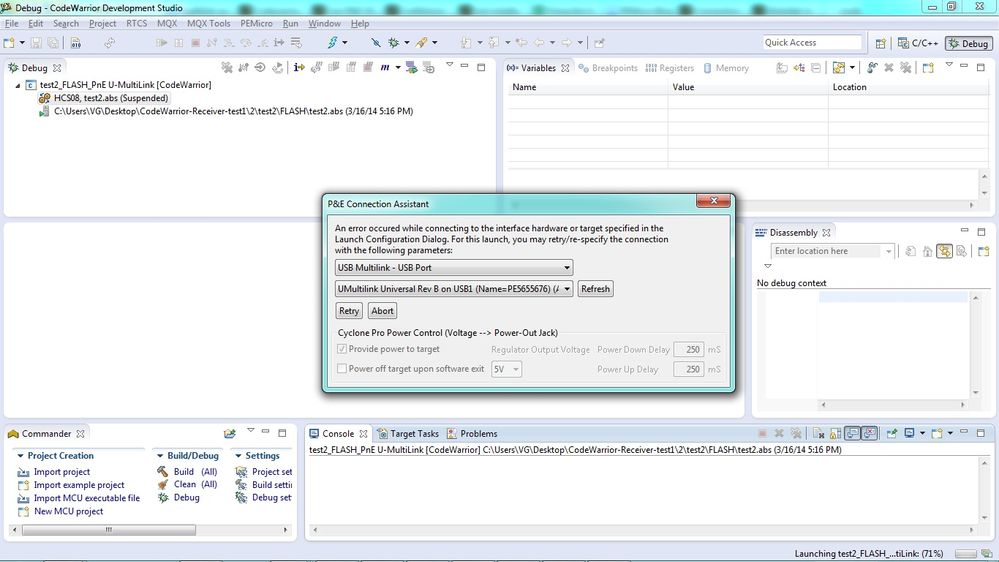

image 2: this error appears when I run Debugger: it asks to turn off and on the MCU power.

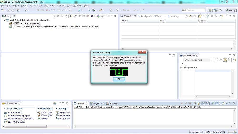

image 3: powering off/on doesn't help with the previous error, and this new error appears, and fails to program/debug.
How can I solve this problem?!

Sometimes the multilink does require for board to be power cycled in order to force it into Background Debug Mode. Please keep your multilink plugged in, turn off target power, re-enable target power and then click OK. Does this allow you to connect to your target or does it return you to P&E Connection Assistant?

It seems that Multilink tries to power cycle the board and force it to Active Background Mode, but nothing happens! every time I try to Erease/Flash/Debug the board It brings up the Power Cycle Error window and whether I power it off/on & click "Ok" or just click "Ok", the result is the same! which brings P&E Connection Assistant.
