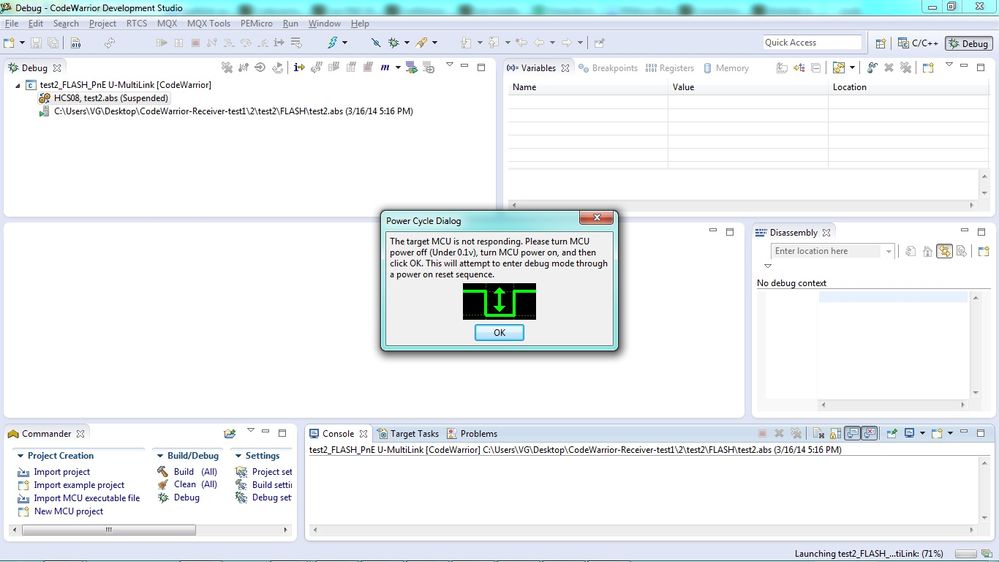

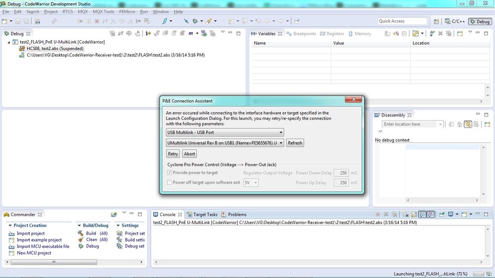

I want to program MC12311 IC which has HCS08QE32 MCU in it, using PE USB Multilink Universal and CodeWarrior 10.5 on a win7-64bit platform.
codewarrior detects Multilink Universal Programmer but fails to connect when erase/debugging mcu.
here are the screenshots of problems:
image 1: the Multilink Universal is detected and installed automatically by windows. (USB Multilink 2.0)
image 2: this error appears when I run Debugger: it asks to turn off and on the MCU power.

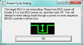

image 3: powering off/on doesn't help with the previous error, and this new error appears, and fails to program/debug.

I would carefully check the pins and power supply of the microcontroller.
I had this in the past with wrong pin mappings, or wrong power supply to the board.
The other reason for this is if the microcontroller has been permanently secured: in this case, there is no way except to replace the microcontroller on the board.
Some background: that dialog comes up if the debug interface does not get any response from the target.
The other thing to check are all the BDM pins to the microcontroller. I had a case where they the footprint on the board were wrong, and then of course debugging did not work.
I hope this helps.

Sometimes the multilink does require for board to be power cycled in order to force it into Background Debug Mode. Please keep your multilink plugged in, turn off target power, re-enable target power and then click OK. Does this allow you to connect to your target or does it return you to P&E Connection Assistant?
I would also follow Erich's advice and check all power connections on your target board, make sure that VDD, GND, RESET and BGND pins are properly connects to the BDM header and that you have pull-up resistors on BGND and RESET lines.

I follow the wizard when creating new project and I select MC9S08QE32 since there is no MC12311 in the list (MC1321 and MC1323x Families are available but MC12311 is not there).
It seems that Multilink tries to power cycle the board and force it to Active Background Mode, but nothing happens! every time I try to Erease/Flash/Debug the board It brings up the Power Cycle Error window and whether I power it off/on & click "Ok" or just click "Ok", the result is the same! which brings P&E Connection Assistant.

as I mentioned before it seems that the problem is related to power cycle procedure and I have to find how to initiate power cycle to my board. by the way I've updated driver but no success. even I checked 2 different versions of Codewarrior (10.4 and 10.5) but no success and I face this error every time:
