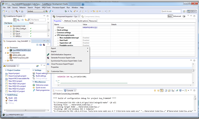

This is my configuration:
    Windows 7 64 bit
    CW for MCU V10.6.4 (all updates installed - 10.6.5)
    MQX v4.2
With this configuration I've opened the \Freescale_MQX_4_2\mqx\build\cw10gcc\bsp_frdmk64f\bsp_frdmk64f.wsd file.
To generate the bsp, I've generated the PEx code and after build the bsp_frdmk64f project.
I can build the project without problem.
It seems it's not the case on your side - in this case you should have a problem.
Did you changed something in the PEx configuration ?
All files included in the Generated_Code are removed and re-generated when you select "Generate Processor Expert Code".
So if you applied some modifications in a file listed in this project folder for instance in cpu.c file, all modifications will be lost.

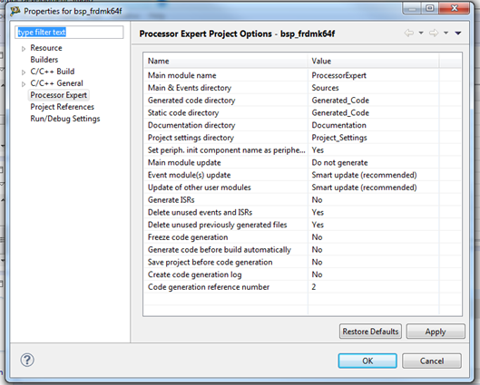

Now there are some options for Processor Expert which can be defined via the properties.
To access them click on View Menu + Properties
Here you can modify some settings if you want.
The  Freeze code Generation can be switch to YES to freeze the code. Then Processor Expert code can not be re-generated.
Excepted this option forbidden the PEx code generation, in all other case the files listed under Generated_Code Folder will be always updated
