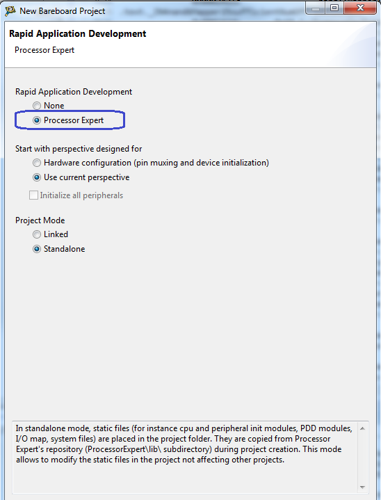

I am new to CodeWarrior and was informed there is a function which can generate code for interface with Pins.  I need to setup the A to D converter also some GPIO lines for input and output (not the same lines)?
So I need help in how to use the application as well as what the application is to perform this function.

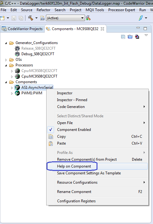

User can use Processor Expert to easily configure a pin, or a peripheral module including ADC.
When creating a new bareboard project in CodeWarrior, please enable the option of ‘Processor Expert’.
For how to use Processor Expert, please refer to its help documents, usually it is:
C:\Freescale\CW MCU v10.6.4\MCU\Help\PDF\ProcessorExpertHelp.pdf
For how to use each bean, please read the bean’s help pages. To open them, please place the mouse on the bean’s name in Components View, and right click the mouse and select Help.
