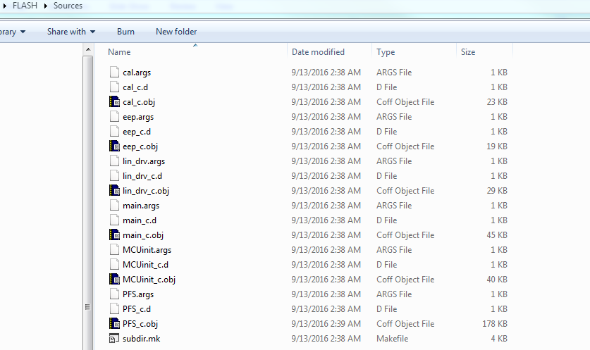

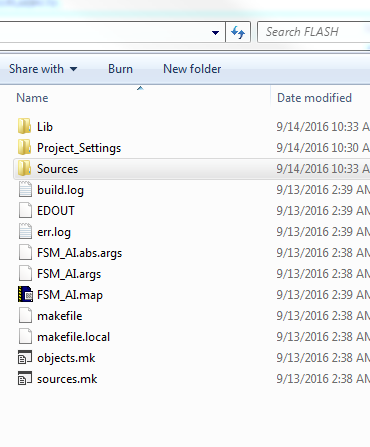

When I run the build, a makefile is generated. this makefile creates object files named like "main_c.obj". However, when the link phase is attempted, the linker is looking for "main_c.o", which not what the compile phase created.
The error message is "ERROR L1302: File main.c.o not found"
I have looked at the makefile and various (also generated) subdir.mk and other sub-make file, but I don't see where "main_c.o" came from.
Any suggestions how to work around this problem?

The generated makefile and generated sub-makefiles (see attached) create "main_c.obj", but not "main_c.o"
The PRM file (see below) does not reference "main_c.o", therefore, the generated makefile must be telling the linker that "main_c.o" is needed. I can not find where the makefile is doing that.

I open and (try to) build the project using the CW 10.7 IDE.
I created the project by using the New Project wizard to create a "CodeWarrior Bareboard Project".
Then I created new files in the project for application sources, then copied the source files from the legacy (CW 6.3) project in to the the new CW 10.7 project.
(Except for main.c, I did not change or replace any of the generated files.)
Then, in the "Commander" panel, I clicked "Build (All)". The build process ended with the linker error: "ERROR L1302: File main.c.o not found"

I can open your project with your project files but I just found your folder doesn't include other source files (eg, C, prm...)
the source folder includes the intermediate .d .obj file but not source c files.
please make sure the folder includes all the source code and you can open and build it on another computer.
