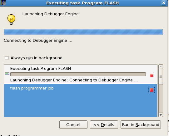

I have created a FLASH Programmer task, yet when I run it the following is the output I get.
I am using Linux version of CodeWarrior
Installed Products:
- CodeWarrior for Power Architecture
     Version: 10.3
     Build Id:130315
I had this running on a Windows Codewarrior v10.1.1 but am now stuck at this point having migrated to Linux.
Any help gratefully received.

Can you please provide the board name and the Linux distribution?
Also, can you please verify if you have any DE or ccs hanged processes?
Thank you,
Marius

Hi, the target is our own hardware with a P2020 on it. We have
successfully used the CW PA 10.1.1 (WinXP) with this hardware, via
USB-TAP.
Linux is CentOS 5.9
cwde process is sleeping, no ccs processes
Rowan

Hi, 32 or 64bits?
Marius
2,990 Views
rowancarter
Sorry,
64 bit
Rowan

There is any chance to upgrade to CentOS 6.3? Officially, we don't support CentOS 5.9. According with the information from README.txt file we support only next distributions:
   32 bit
      2.1 RedHat Enterprise Linux 5.4
      2.2 Ubuntu 8.04
      2.3 Ubuntu 9.10
      2.4 Fedora Core 11
      2.5 Suse 11 Server
      2.6 RedHat Enterprise Linux 4
      2.7 Ubuntu 10.04
   64 bit
      2.8 RedHat Enterprise Linux Server 5.4
      2.9 RedHat Enterprise Linux 4
      2.10 Fedora Release 11
      2.11 Suse Linux Enterprise Server 11
      2.12 Ubuntu 10.04
      2.13 Ubuntu 11.04
      2.14 CentOS 6.3
      2.15 libexpat system library
Marius

sadly our dev environment needs to be the old CentOS version - I am
looking at possibly providing an upgrade, also requested a Windows
download that may get us going.
Rowan
