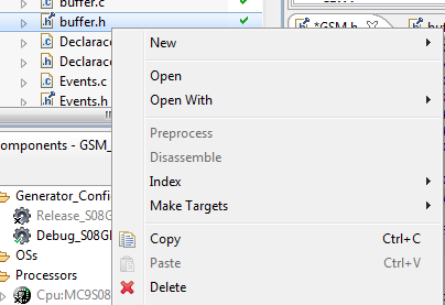

I´m starting to use codewarior 10.x and I remove some files from the build to make some tests (click on the green mark) but when I enable again the key icon appears only on the .h file and I dont know what means.
Some one could help me to explain what is the icon and how can I remove it?

The KEY icon shows that the file has other settings than the rest of the project that it belongs too. For example the project might have debug information enable while the file has this disabled.
This is a simple way to check if all your files inherits the projects settings.
To get rig of it you need to right click on that file then select /Resource Configuration/Reset to Default
Hope this helps!

But for .h files this option is not in the menu.

hi,
I use CW10.6.4, this option exists on my side for .h file.
see my video attached.
can this help you?
