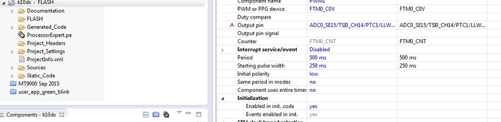

I set up a simple project for K10 and add a PWM component to it. No matter what I try, CodeWarrior keeps giving me configuration errors. Please refer to the attached image. The two red lines are the errors. Please let me know if you have any suggestions. Thank you.

there is no problem to set 500ms period on my side. see attached project.
if this can not solve your problem, please send your demo project. thus we can know your problem on your specific project. thanks!

Thank you for the reference project. I could not figure out what was wrong with my project, so I deleted it and started all over again from scratch. This time it works. I can set the period and the duty cycle properly now.

Hello Liu,
Please click the  ... button to select the period .
