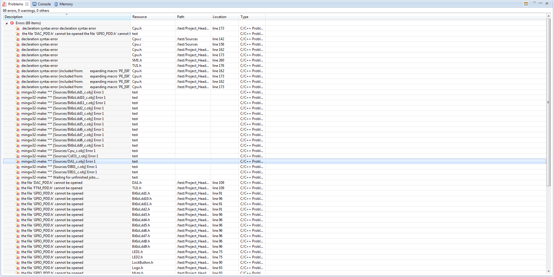

Upon attempting to build the project, I encountered a number of errors. I am thinking perhaps compiler paths are not set-up correctly in codewarrior or maybe the source/header files in the project are not organized in the correct folders. I've included details & screenshots below of how I have setup the project, and errors encountered:

Building the project (screenshot attached):
This is where I encounter a ton of errors; majority of build the errors are:
  • “the file 'GPIO_PDD.h' cannot be opened“
  • “the file ‘SPI_PDD.h’ cannot be opened”
  • “the file ‘UART_PDD.h’ cannot be opened”

Hello Kayvon
Your old project was based on Processor Expert.
Is it possible to get the whole project folder from your colleague? And copy it into your workspace, then import it into CodeWarrior.

ZhangJennie
the files such as xxx_LDD.h are generated by processor expert. if you create a normal project without processor  expert and import those files, normally your project can not pass build.
I suggest you first try import your entire  project directly. If you still can not do it, please create a case and send your project to NXP support. we will check the problem directly with the project.
