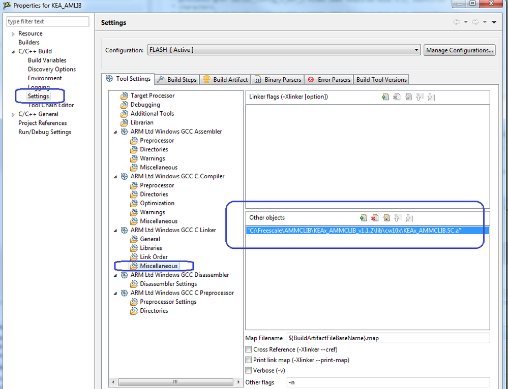

  I am building a motor control project by CodeWarrior ver. 10.6,  follow the guide "Automotive Math and Motor Control Library Set for KEAx devices User's Guide", and work on "3.10 Library Integration into a Freescale CodeWarrior Eclipse IDE"‧
  Then I have the problem:
  1) The environment is different between the guide figure and CW IDE, so I cannot sure if I have done the library linking or not.
  2) After built, I got the error message:
DescriptionResourcePathLocationType
cannot find -lD:FreescaleAMMCLIBKEAx_AMMCLIB_v1.1.2libcw10xKEAx_AMMCLIB.UC.aaaaaC/C++ Problem
  Besides the slash,it's the right address.
  thanks!

Hello KuanYuen
Please open the Project Properties, remove your old setting for ‘Libraries’ in ‘Paths and Symbols’, add the library instead in the <ARM Ltd  Windows GCC C liner -> Miscellaneous -> other objects>, please see the screenshot in below:
Does it work?
