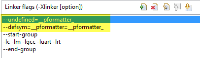

it is not PE. It is the startup code and linker settings which adds to the size. I'll see if I can come up with some suggestions how to strip that down to around 400-800 bytes total. But what you can do right away:
There is a linker symbol defined which I think makes sense in the context of using an UART with printf(). But if you are not using this, then you get the startup code down to around 800 bytes (so 2 K less):
go to the linker options, and here remove the two lines marked in yellow below:
Hope this helps,
Erich

pengliang
Erich,
Thank you for helping me to shrink code size. I would try it. but if I remove these two lines, would it affect my code? or give compile error? I am not quite sure what do that two lines do. Does it just do printf() using UART?
20,362 Views
BlackNight
Peng,
yes, as long as you are not using these formatter/sprintf() (I think?) things, you can remove it. The linker will complain otherwise, then you can re-add the lines. So safe to remove them.
