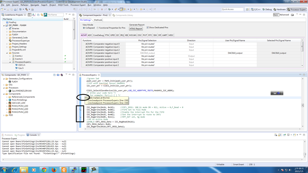

I debug a project . In the beginning it was running well.
Then I found all the break points I add , it shows "Multiple markers at this line"
And it won't stop when I debug.
It's a bug or I have to do some setting to fix the problem?(Reinstall codewarrior?)

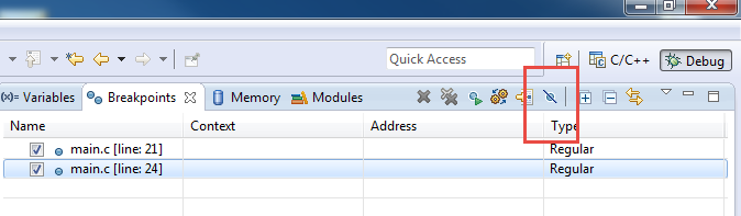

hello,
I ever had similar problem as yours. the problem was solved by
1. remove all breakpoints in "Breakpoints" window as Erich suggested.
2. make sure you didn't select "Skip all breakpoints" button.
can this help you?

修華許
Zhange Thanks. I didn't notice that.
It really helps .

What is your breakpoints view showing (Window > Show View > Debug > Breakpoints)?
You can delete your breakpoints there.
I hope this helps,
Erich
2,675 Views
修華許
It show only one break points at that line.
But the break point still doesn't work.
Program won't stop there
