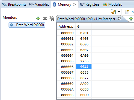

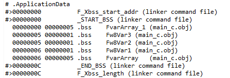

From the xMAP file, we can see how these variables are located:
It is obvious that w8Var1 occupies the lower 8 bits of address 0x06, and varArray[] starts from the higher 8 bits of address 0x06, which can be an issue if 'varArray' is converted into a structure pointer.
You can also check it out from the memory show as below. (Default little endian is applied for display)
Please have a check, thanks.
