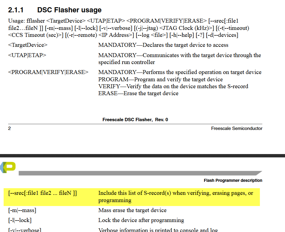

  1. Here we want to improve the programming process, is there any way (except use codewarrior) for onboard programming?
  2. “56800E flash programmer 1.2” whether support MC56F84789/567? If support, where can get “Device Configuration file” (xx.cfg)?
  3. Freescale DSC Flasher” whether can download BIOS and App file at once?
    Here I use CMD:
    fflasher MC56F84789 utap program -m --srec:BIOS.S  APP.S -v -j 1000 -t 5 --log D:\TestLog\log.txt
    Not running.
    Use CMD:
    fflasher MC56F84789 utap program -m --srec:BIOS.S -v -j 1000 -t 5 --log D:\TestLog\log.txt
    Only can program BIOS, then go through CAN network download APP.

I find the problems:
Here i used WinMerge to compare .HEX & .S (*elf.p.S, *elf.S) file from CodeWarrior.
I find there have some different on count backwards second line "S30700000FFE1ADAF7", .HEX file have this, but .S file don't have. So i just use .HEX File rename as .S then program BIOS.S and APP.S into DSC then working fine.
If programming original *elf.p.S file (BIOS.S & APP.S), only BIOS running.
It's a little confusing for this.https://community.nxp.com/community/codewarrior/cw-mcu
CMD:
ren C:\XX\*.HEX *.S
fflasher MC56F84789 utap program -m --srec: C:\XX\BIOS.S C:\XX\APP.S -j 800 -t 5
ren C:\XX\*.S *.HEX

“56800E flash programmer 1.2” doesn't  support MC56F84789/567.
User can use "Freescale DSC Flasher” for it.
according to user manual.
http://cache.nxp.com/assets/documents/data/en/application-notes/AN4824.pdf?fsrch=1&sr=1&pageNum=1
Please try if you can download list of files with it.
Hope this helps!
