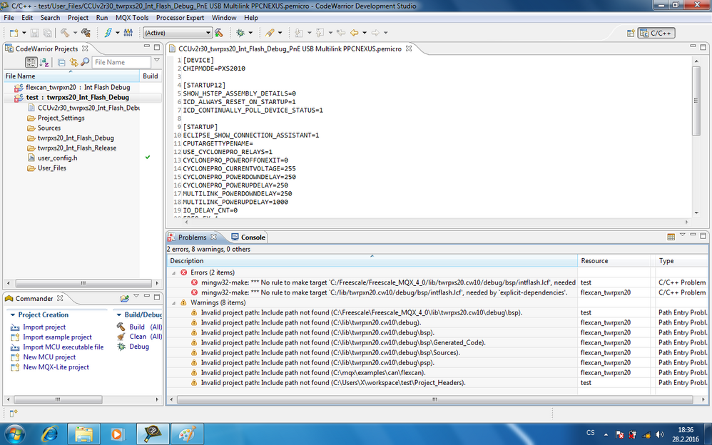

Good day,
I have problem with compiling projects in CW 10.4.
It is saying mingcw32 No rule to make target and Invalid project path.

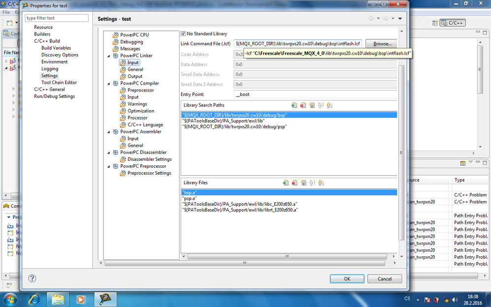

Maybe it is soething with settings on the second image, but i don´t know.
I am total noob, please help.
Tanks for anny suggestions.
Have a nice day, Aleš.

Hello Ales
Before compiling the project, please first compile the PSP and BSP library projects. Please also make sure that when you perform a clean and rebuild operation on your project, the PSP and BSP projects are not selected, otherwise you will need to compile them again.
Best Regards
Fiona Kuang
Technical Information & Commercial Support
