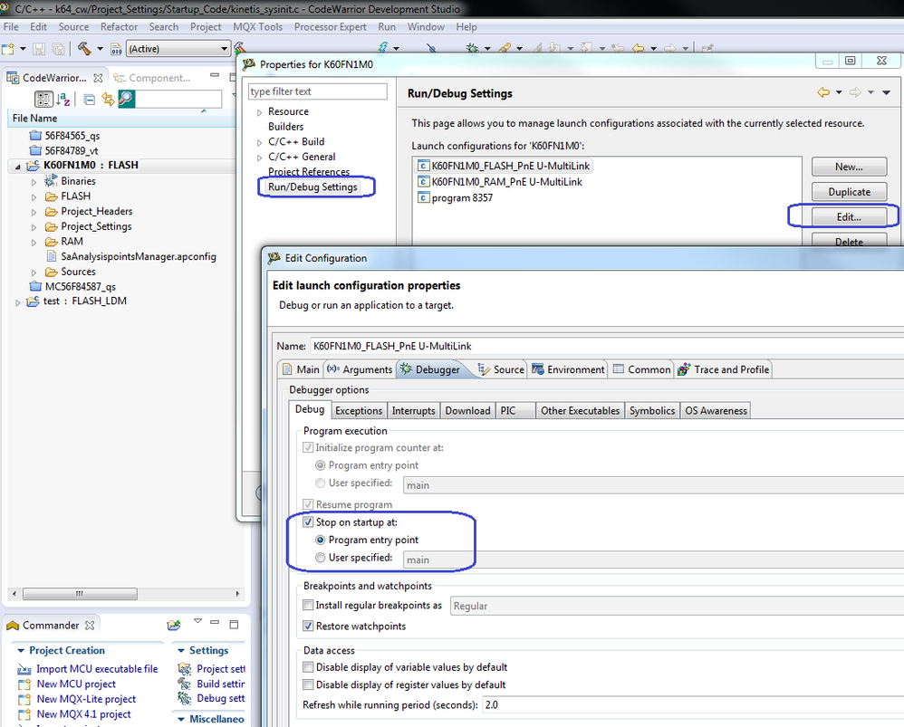

First, please open ‘Project Properties’, then go to ‘Run/Debug Settings’.   Choose your launch configuration and under ‘Debugger’ tab, set ‘Stop on start at’ option as ‘Program entry point’.
Then start downloading program again, the debugger will hate at the entry point. You can step into the program to find out the problem.  For how to find out the root cause, you may refer to:

armendgecaj
Hello Kuang,
thank you. I will try it.
But perhaps i have already found the problem. I think my global variable is to big (Labyrinth[240][320]).
If i decrease my global variable then i get no hard_fault.
I explained it in my answer to Alice.
Now the question is, is it possible to work with such big global variables?
Best Regards
Armend
