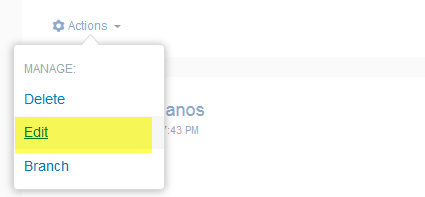

unfortunately I couldn't download your ttf and screenshot. can you please upload it directly as attachment.
click on "Actions"->"Edit" you can find the attach button
Jennie Zhang
10,303件の閲覧回数
barakmanos
Done, thank you.
