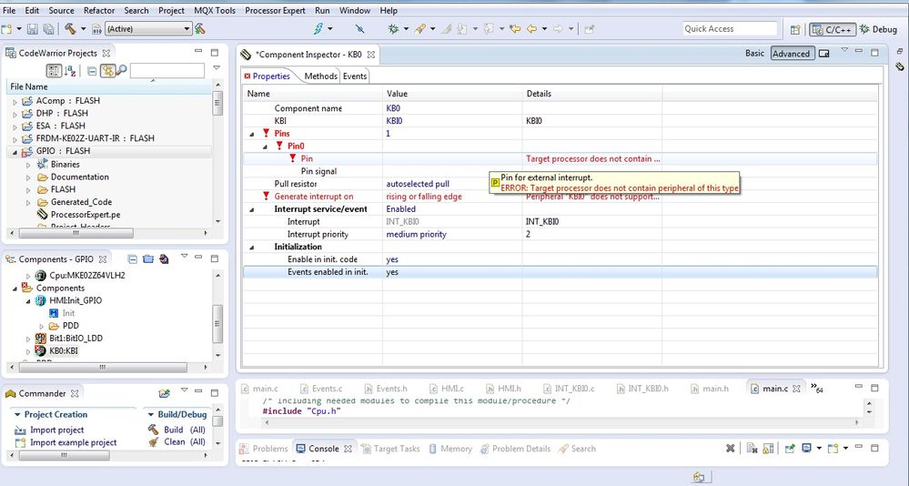

siamackghadimi
I use Codewarrior 10.6 with Freedom FRDM-KE02Z4 board and MKE02Z64VQH2 CPU on board.
I add KBI1/KBI0 component for specfic pin to my project but when I want to add a pin, I will get the message "ERROR: Target processor does not contain peripheral of this type".
Why?
Please check the image attachmed
Thank you,
Siamack

trytohelp
Dear Siamack,
Don't think your question is really linked to this old question.
I recommend you to create a new issue.
Pascal
NXP Technical Support
