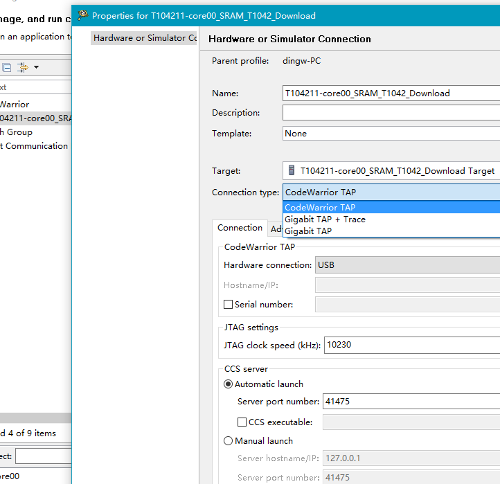

Does CodeWarrior USB TAP support T1042 ?

CodeWarrior Development studio can not find USB TAP

Hello wei ding,
NXP has discontinued the support for USBTAP and ETHTAP starting with general
available release v10.3.3 (3 years ago) but they have continued to be available for older
setups. Supporting newer parts (i.e. T1040 and newer) is not possible due to technical
limitations. CWTAP (over Ethernet or USB) is the recommended probe.
This could be found in CW release note.
Lunmin
