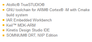

I am looking at some MCU code with no background or documentation.
I'm following one clue, an include file named Kl26zSetting.h.
In what SDK or IDE would that have been used ?

Hello Louis.
I don't think NXP has SDK that includes Kl26zSetting.h.
CodeWarrior doesn't support KSDK. if using CodeWarrior, user uses MQX instead.
KSDK is only supported by
Software Development Kit for Kinetis MCUs|NXP
both CodeWarrior bareboard project and some of MQX CodeWarrior demo code use "derivative.h"

Correction.
The SDK file appears to be "derivative.h".  Does that ring a bell for anyone?
