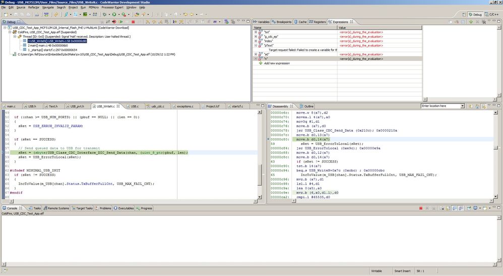

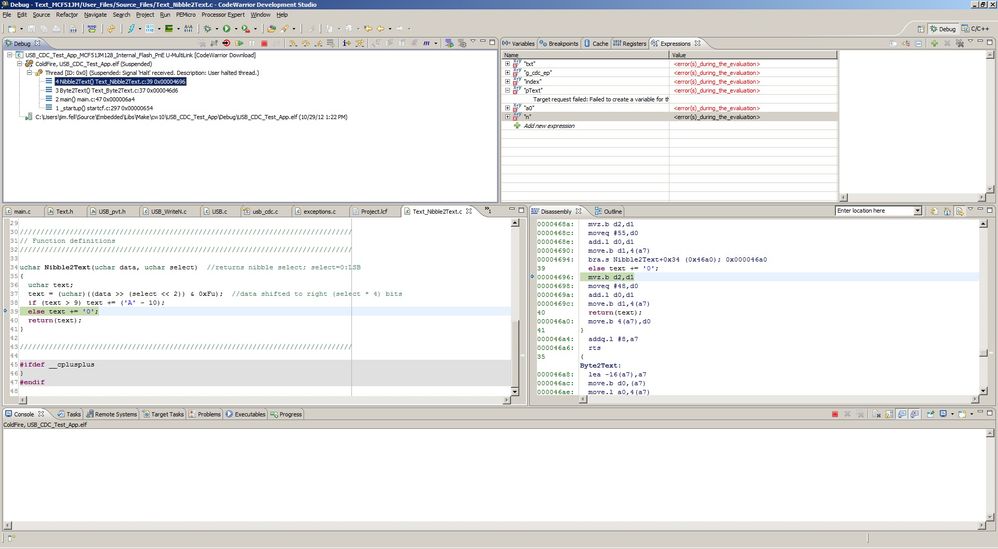

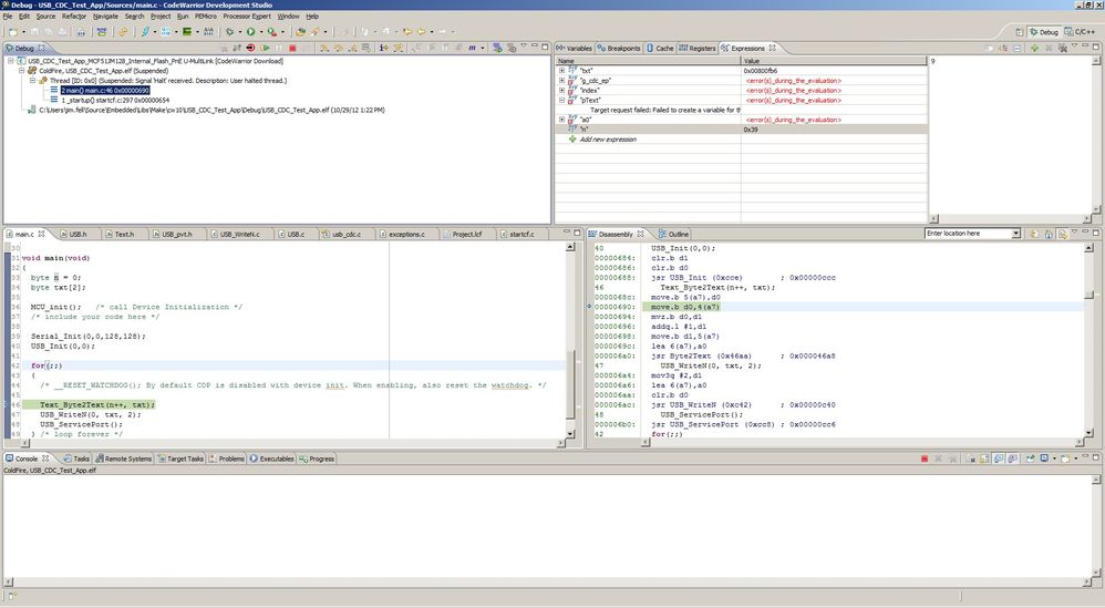

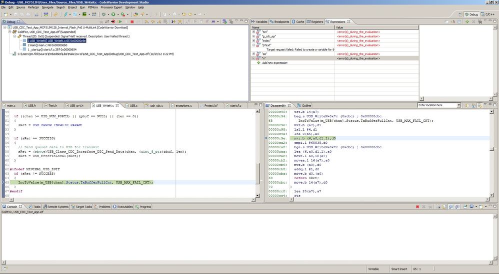

My CodeWarrior 10.2 project unexepectly halts execution when in a debug session.  The message I see in the Debug pane states, "Thread [ID: 0x0] (Suspended: Signal 'Halt' received.  Description: User halted thread.)"  I did not halt target execution, so I don't know what it's talking about.  It doesn't give me any other meaningful information.  I'm new to CodeWarrior/Eclipse, so there's probably something obvious that I'm overlooking.  My target code is running version 4.0.2 of the Freescale USB stack, if that makes any difference.
I've attached a few screen captures.  It seems to randomly halt in different locations.  Any insight or suggestions would be appreciated.  Thanks.

unfortunately your screenshots have been compressed/blurred to the point that they are not really readable any more.
Looks like your CPU has been halted, and that might have multiple reasons, including an access error.
You could try to enable loggin in the connection settings:
that way you get more information.
You find that setting in your Launch/Debug Configuration, then press 'Edit' on the Connection in the 'Main' tab.
