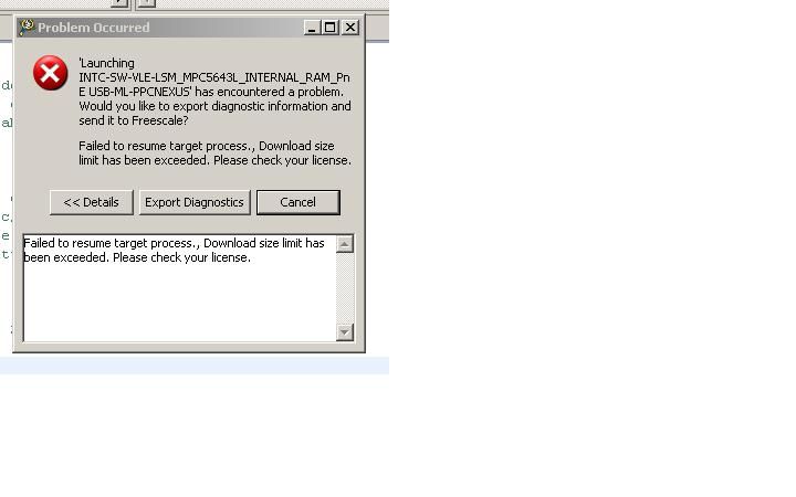

edigs
Hi there i have instaled CODEWARRIOR 10.4 special edition and at the debug section, the program had comed up with such an error. I would be very glad if someone could help me Thank you.

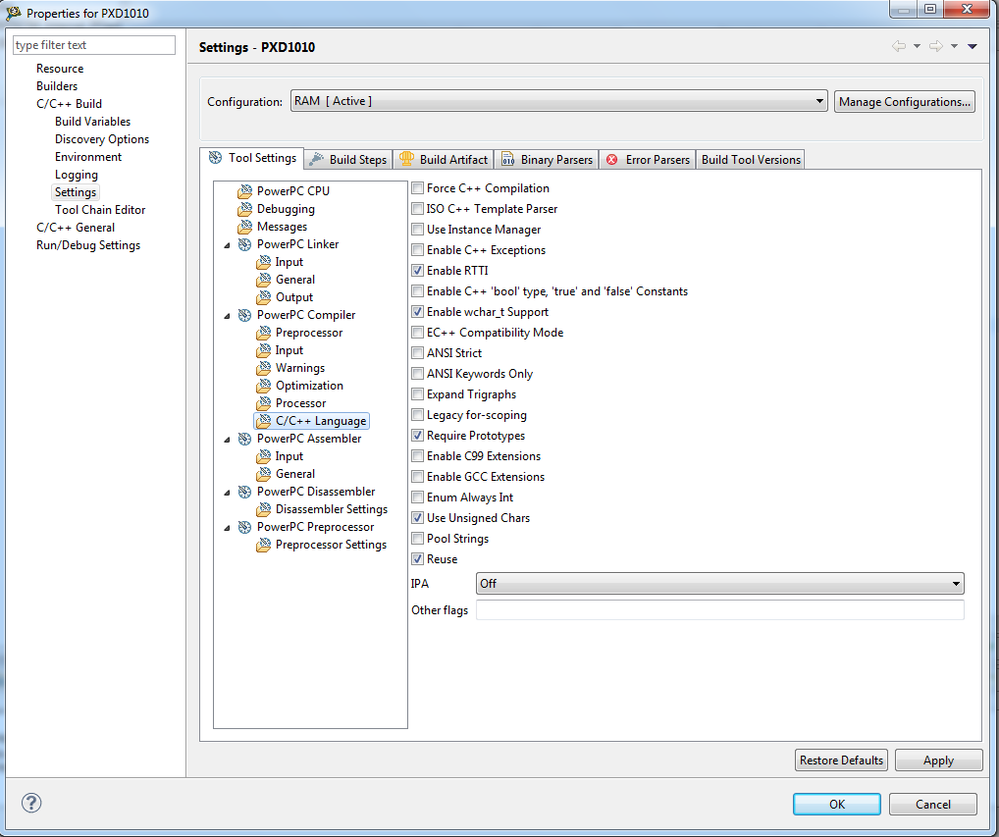

TICS_Fiona
Please check whether the C code size is beyond the limit of your license.  Or did you enable C++ feature in your project? C++ language is only supported in professional edition. Please disable the C++ settings of the project as  below:

edigs
Thank you it work´s like a charm :smileygrin:

BlackNight
The message indicates that you your exceeding the allowed download size for your license configuration. Are you using the free edition?
And: are you using C++ (intentionally or unintentionally)?
See Please Check Your License | MCU on Eclipse
Hope this helps.
