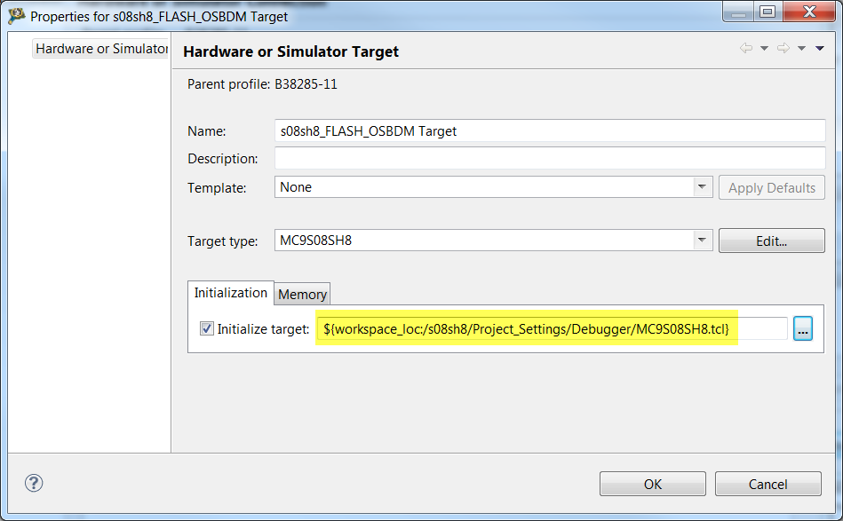

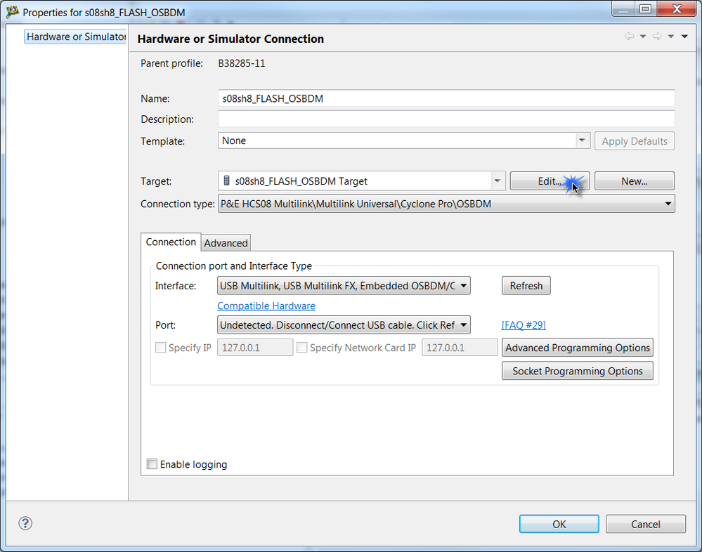

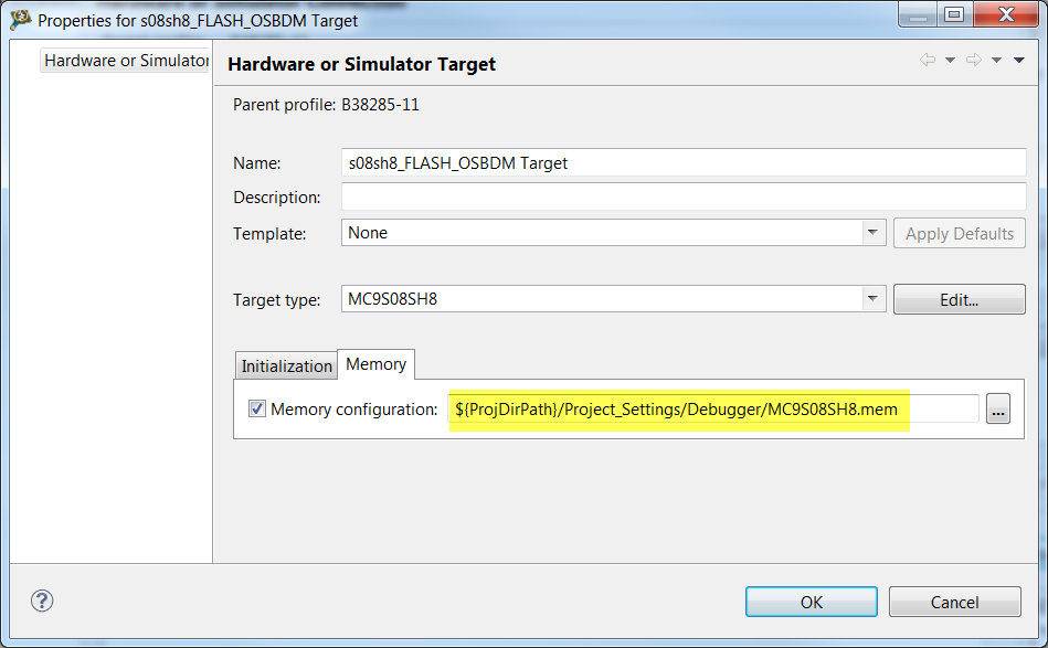

I have just changed my hardware environment from DEMOQE to a USBDM connected to my S08SH target board. I have changed the debug configuration to USBDM, but when I launch DEBUG I get the message
"Could not open memory configuration file".
When I investigate the target properties I find "The path is not valid in all configurations" and "File is invalid"
What can I do about it?

I believe it would be better if you create a new project for the S08SH MCU and develop based on this project. When you create a new project the Initialization and Memory files needed by the debugger will be added to your project inside the Debugger folder:
Once you have them you can use these files for your new USBDM connection following this steps:
Hope it helps!
