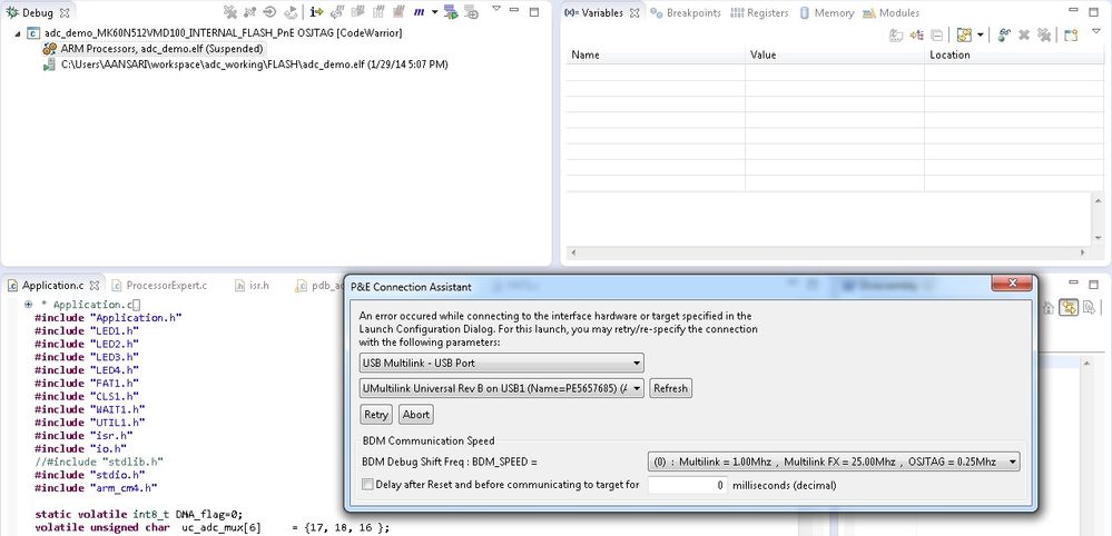

Hallo All
I am trying to debug a project via USB Multilink Universal and have its connection from Port-F-Mini-20 (USB Multilink) to Cortex debug on board, with J12 settings off and power USB connected on USB MiniAB on TWR SER Board.
It functioned for the first time and since then its giving me following error when I am debugging it
Any solution?
Abdullah

I've performed some tests on my side.
My config is:
      Win 7 32 bit
      CodeWarrior for MCU V10.5
      P&E Multilink Universal Rev. B
      Tower Elevator + TWR-K60D100M (including a PK60DN512)
I've created 2 examples. First is using OSBDM and second Mulitlink Universal.
I'm able to load the example using OSBDM and Multink interfaces.
For Multilink Interface.
First connection
when  no power supply is applied on TWR-ELEV I got
Now Close the debug session, switch on the power and re-launch debug.
Now it's running fine
Attached the Multilink example.

Hi Pascal,
Thanks for the answer. I appologize for the late response. I got the problem solved as i was connecting the PE link Multilink USB wire to wrong USB Socket on the board and it wasnt powering the board up.
