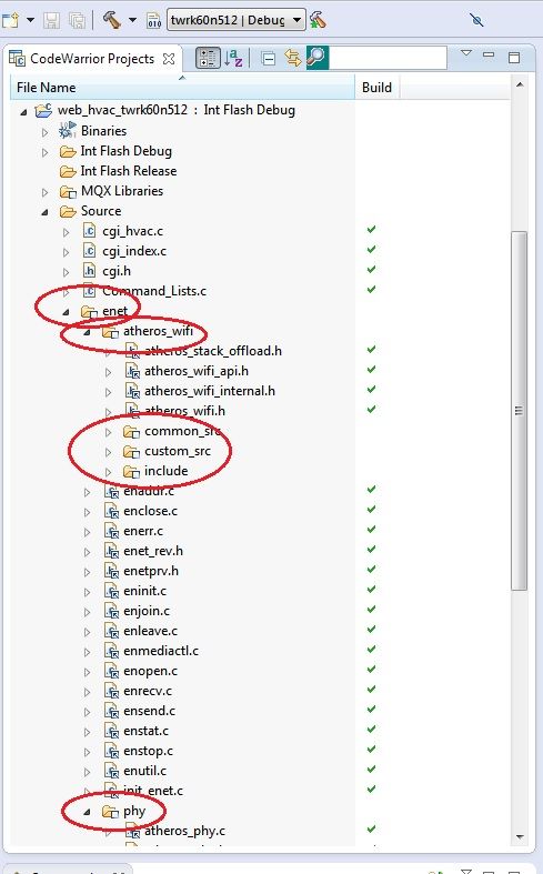

Hello Community,
How can I create/add some sub-folders in the Source Folder once I create a new MQX project?
These sub-folders can contain some other source files which could be located in other locations rather than ‘source’ folder.
A good example would be web_hvac project in atheros_wifi package. As you can see in the figure in Source folder
there are some other folders like ‘enet’ or ‘phy’. The actual location of these folders are somewhere else rather than
in the ‘source’ folder in the hard drive; but they linked and showed up in source branch.
I use CW 10.5.
Cheers!

the simple way is to drag the folder from windows explore to the project folder in "CodeWarrior Projects" window directly. when you perform drag, CW will pop up message as below. you select the second or third. the folder link will be added to the project.
can this help?
