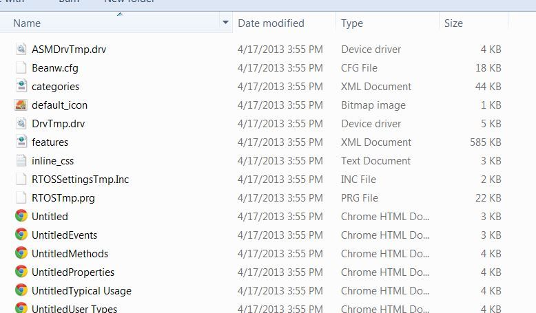

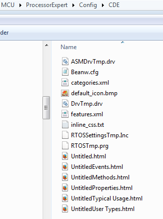

that message sounds like the CDE somehow is not installed. Can you verify that you have this folder present in your installation:
C:\Freescale\CW MCU v10.6\MCU\ProcessorExpert\Config\CDE
Mine has the following content:

When I go to
C:\Freescale\CW MCU v10.6\MCU\ProcessorExpert\Config\CDE I see the same exact content that you see..
