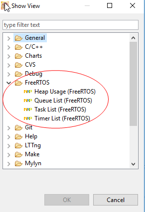

Hello Carl,
Sorry  it  seems the server hang up , it is the same error on my side.
What software you want to install , maybe now we can download it , then isntall it use the offline mode
as a workaround now.
If you want to use the FreeRToS features on KDS v3.2 when debug,  you can open them at :
Window -> show view -> other...
