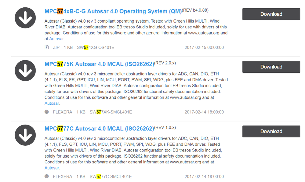

Query: 2.       Can you please let us know the price for AUTOSAR MCAL and OS for MPC57xx?
Answer: It is Free from NXP...
Refer AUTOSAR (Classic) Version 4.0.x|NXP
