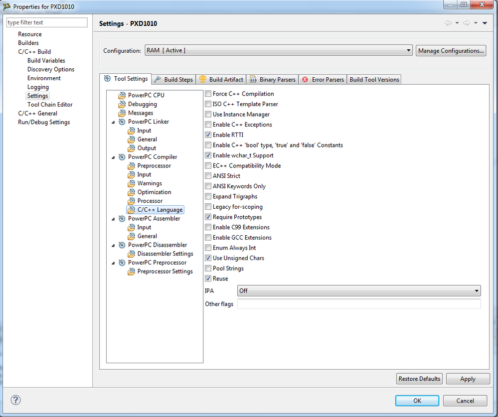

Hello everybody,
I'm developing an application for the MPC5668G with CodeWarrior 10.6.4. When I try to download and debug the code I get a license error ("Current license does not allow downloading C++ code"). For my application I only use C code so I think the problem comes from the included header files which contain C++ code. How can I solve this problem? Do I have to delete the C++ code in the header files?

Hello Tim
What license are you using?
For the restriction with Basic, Standard and Professional license, please refer to:
http://www.freescale.com/files/soft_dev_tools/doc/fact_sheet/950-00437.pdf
The evaluation license works same as professional license, but when it expires, it will work as special license. Special License does not support C++, and it also has code size restriction.
Please check your C code size, and also check whether C++ feature is enabled in the project.  Please disable the C++ settings of the project as below:

tim_09
Hey Fiona,
with the settings shown in your picture the download works and I can debug my code. Thanks for your help.
