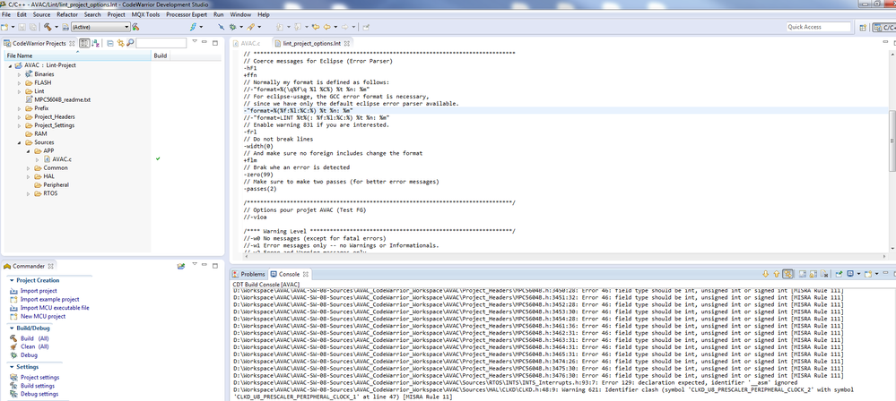

I'm writting a procedure to use PC-lint (without plug-in) using the following method:
JB Enterprises – Johan Bezem » Blog Archive » Using PC Lint in Eclipse – no plug-ins required
But I've a problem, in the console window, the message are not highlighted and I can't make the link between the error message and the source code.
Normally when there are error messages in the console window, there is a link with the source code:
But in my case, the error messages are not highlighted and there is no link with the source code
I've a project working but I don't know to reproduce this configuration. I compared the properties of the project, the CodeWarrior preferences but I didn't find where does come from the problem.
Do you know which option is needed to hightlight the error messages?

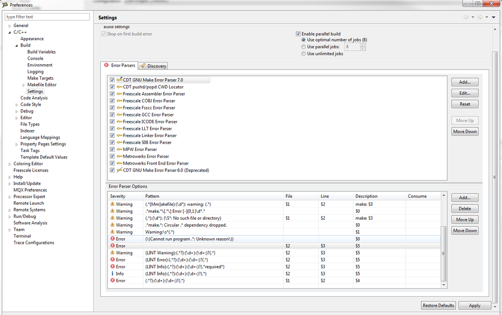

I found my problem:
I need to configure the settings of the CDT GNU Make ERROR Parser 7.0 with the follwing settings to add the messages from PC-lint.
To do that, go in the project propertie\C/C++ Build\settings and select Workspace Settings .
Add the following options :
Error        (LINT Note):(.*?):(\d+):(\d+:)?(.*)                 $2    $3    $5
Warning   (LINT Warning):(.*?):(\d+):(\d+:)?(.*)           $2    $3    $5
Error        (LINT Error):(.*?):(\d+):(\d+:)?(.*)                $2    $3    $5
Error        (LINT Info):(.*?):(\d+):(\d+:)?(.*required*)   $2     $3    $5
Info          (LINT Info):(.*?):(\d+):(\d+:)?(.*)                  $2     $3    $5
Error        (.*?):(\d+):(\d+:)?(.*)                                   $1     $2    $4

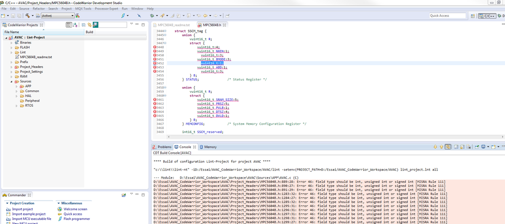

jean-christoph7
I used a similar method to lint a current file.
But the problem, when we use an external tools, there is no link between ther error messages and the osurce code.
The used another method in use a new build configuration. With this method I arrive to link the error messages with my source code (error messages appear in the Console window and in the Problems window of codewarrior). But when I apllied my method on a new project, there is no link between the errors and the source code.
