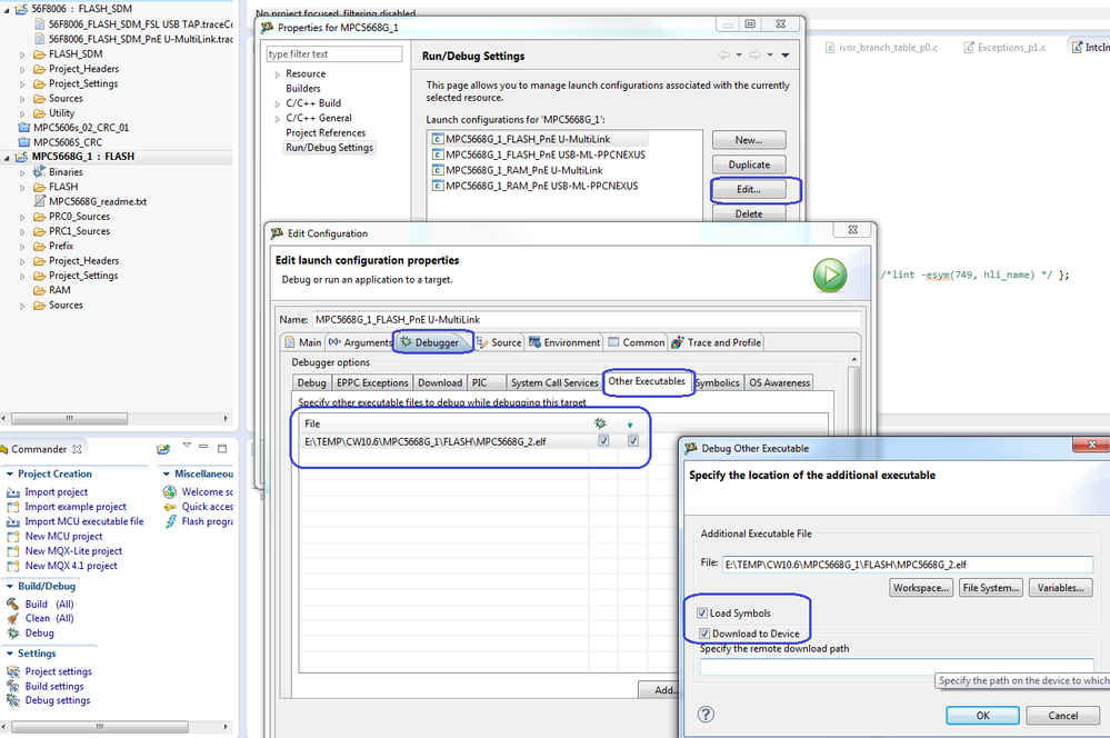

TICS_Fiona
Hello Tim
If you would like to load two .elf files into CW debugger. Please open the debugger configuration window, and under the ’Debugger’ tab, please select ‘Other Executables’. This option allows you to specify a second .elf file with symbols to download.

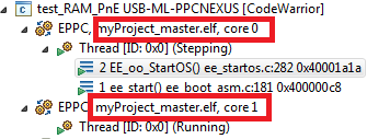

tim_09
Hey Fiona,
thanks for your reply. I've followed your instruction but still he loads the same files on the cores (see picture).
What do I have to fill in the field Download path for the second file when it is intended for the second core (core1)?
Tim

martin_kovar
Hello Tim,
if you created basic project for MPC5668G in CodeWarrior, you have just one elf file. The EPPC core0 and core1 just show you, which core are you currently debugging. If you look to the project folder, you will find only one elf and map file.
Martin
