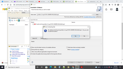

I am following the guide "UM11325 Installing and using CodeWarrior IDE for TPMS for FXTH87,
FXTH87E and NTM88". At CodeWarrior when I try to install either FXTH or NTM88 Starter package, I get an error "no software site found at jar file". How, do I solve this problem?

Hi @Markel , the file or the directory that you are looking for does not exist, that's the problem with it, so you need to redirect the link where you have that file. by the way, we don't have support code warrior more, so i recomend to change to MCUXpresso.
Have a good day

After I extract the contents of the NTM88 Starter Package, the patch was found in the extracted folders and I was able to proceed following the guide.
