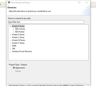

please, i would like to use Kinetis KE1xF series MCU and i can not find it in new project wizard in CodeWarrior.
Is there any way to add other MCUs that are on the list by default?
Or do i need another tool or version of CodeWarrior?
Concrete MCU i would like to use is MKE18F512VLH16
Thank you.

I recommend downloading the MCUXpresso this have support for the family of Kinetis.
MCUXpresso IDE.
MCUXpresso Software and Tools | NXP Semiconductors
SDK builder.
Select Board | MCUXpresso SDK Builder (nxp.com)
You will find examples for your target.
