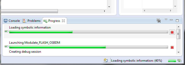

I've been using CW10.5 for three weeks, and have used it on both 9S08 and MCFMM256 projects. Everything went well until yesterday, when the 'debugger-launch' froze with no explanation.
Looking at the 'progress' tab shows this:
Unless one looks at the 'progress'-tab, it's not obvious what;s going on, and any number of launches can be attempted, each one leaving a 'Loading symbolic information' operation that can only be deleted by closing CW.
That "40%" occasionally gets as high as 60%, but never finishes. And clicking the red button does not affect the results, except to note that 'Cancel Requested.' No cancellation occurs
- Working with TWR-MCF51MM demo-board, using on-board OSBDM
- Windows 7, 64-bit
- Re-installed 10.5 with no change
- Installed 10.6 ditto
Does anyone have an idea on this?

That's definitely not normal. Can you check if you Zombie tasks running, see http://mcuoneclipse.com/2012/06/01/killing-me-softly-zombies-and-debugger-engines/
How much RAM does your Windows system have?

... and now it doesn't. "All I did was®" add a table of 12-bit values for sin(x) to the source  and the problem vanished. It works as before and I can't make it fail (not that I tried too hard.)
I couldn't really call this one 'answered,' but I am done with it.

The problem appears to be slow-motion response from the debugger. The 'eternal symbol load' described above will complete, but takes at least fifteen minutes.
More: clicking the 'pause execution' button takes about a minute to happen (this was always the case.).
After a pause, the 'CPU Registers' window, as an example, is populated at about one value every five seconds: this used to be nearly instant.
Editing, re-compiling and reflashing the device has a turnaround time of minimum twenty minutes:

Thanks for the response.
Your explanation of zombie-processes makes sense, and I had already checked Task Manager several times looking for suspects: at one time there were two running copies of DE.exe, but only once, of a dozen or so instances.
It still sits at "Loading symbolic information: 40%" for a reliable 20 minutes. What exactly is going on in that operation?
I have 8GB of memory and have turned off all the big consumers ( big apps, multiple .pdf's etc.)
