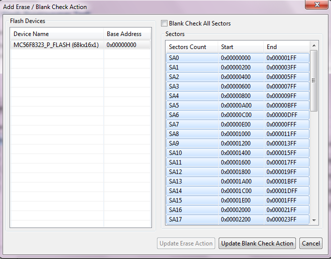

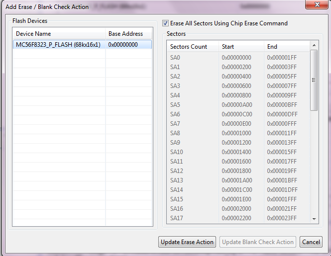

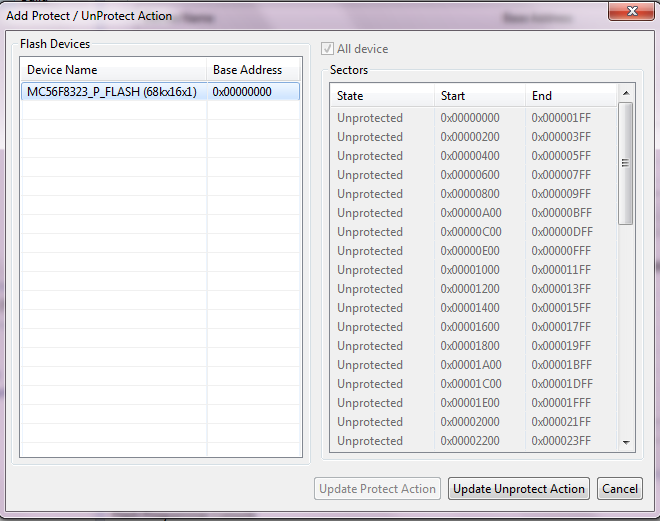

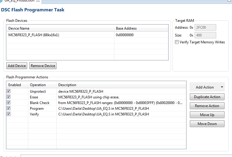

We have used in the past the older standalone 56800E Flash Programmer app that came with the CW8.x tools.  We have upgraded our PC to a WIN7 Pro machine now we are trying to use newer tools for production programming of our products.  We have installed CW10.6.4 and setup the FLASH Programmer as a Task.
I am able to connect to the USB Tap and everything seems to start OK:
Beginning Operation ...
Auto-detection is successful.
  File is of type Motorola S-Record Format.
Erasing ..............
Error:  Erase Command Failed.   Protect violation error.
fl::target -lc "LC for Simple Flash"
fl::target -b 0x2fc00 0x400
fl::target -v off -l off
cmdwin::fl::device -d "MC56F8323_P_FLASH" -o "68kx16x1" -a 0x0 0x20fff
cmdwin::fl::protect all off
Performing target initialization ...
Flash Operation.
Unprotecting .............
Unprotect Command Succeeded.
cmdwin::fl::erase all
Erasing ..........

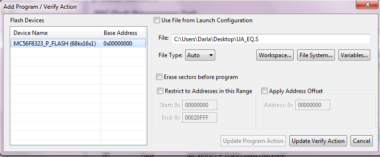

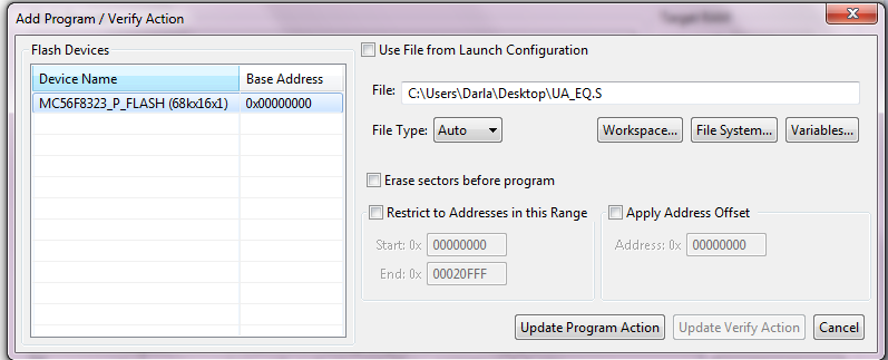

My Setups look like this:
So as you can see it appears everything is setup correctly and I have tried multiple target boards.  Any ideas on how to correct the "Error:  Erase Command Failed.   Protect violation error." would be great.
Dave
2,822 Views
TICS_Fiona
CodeWarrior v10.6.4 has problem in programming 56F8323 with USBTAP, user needs to manually update the .tcl and xml file in CodeWarrior and project folder. For details, please refer to:
https://community.freescale.com/docs/DOC-105548
In addition, 56800E Flash Programmer v1.2 also works on Windows 7-64bit,  please copy the CCS folder in CW10.6.4 and use it to replace the one under 56800E Flash Programmer v1.2. For details, pleases refer to:
https://community.freescale.com/docs/DOC-102607
