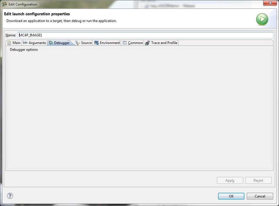

1. Debugger screen just went missing even though it was working yesterday... (have done full reboot, removed project and re added it, still missing). I have not re installed CW4 (although I did several times the other day when we had other issues with it which turned out to be a compiler issue)
The "Connection:" just vanished on a couple of the projects (on the main tab on the screen above). Not sure why, it did work, and I dont know how to make one properly, and im sick of finding things missing so I guess I will start from scratch..

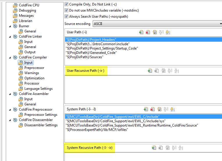

Starting large projects from scratch (due to the above issues) is a real pain. One of the most annoying things is the 30 path's that all need individual adding. I have requested this gets fixed ever since we moved to eclipse, which is now years and half a dozed releases.
Check it out: Is it really that hard to make a check list so you can just tick which folders are included in the path? or a recursive option?

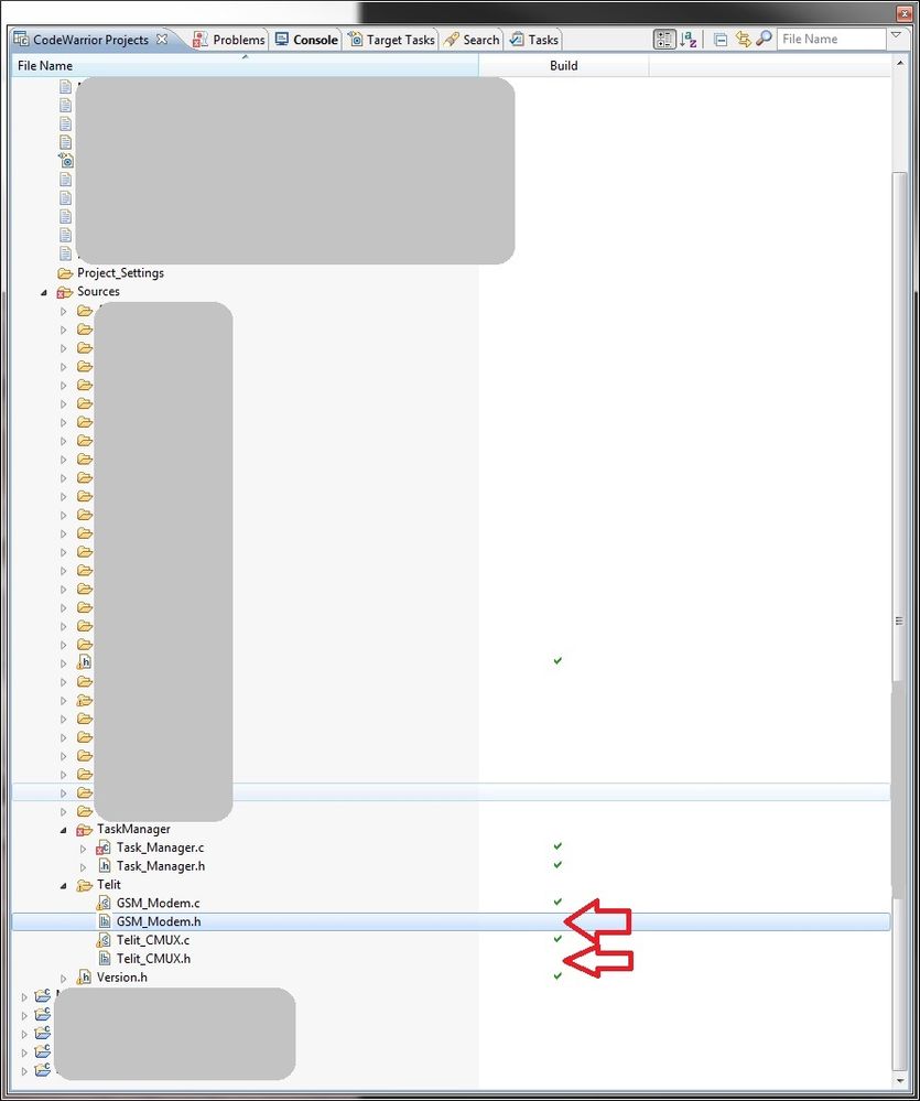

Hi Guys,
I just switched build configurations on my project (MQX4 based, ColdfireV2, Win7, CW4), and it broke all the build configurations as it has some how forced these two files to not be able to be included... Below the two arrows show the box's that are missing that allow you to include the two header files..
Can someone please tell me how to force these box's to appear again so I can manage my project?

Ok, so there appears to be a bug in CW10.4. If you have a file that is excluded from some build configurations and not others, you cant re include / exclude those header files.
There is also no reference to the icon being different for files that are included in some, and not other build configurations.
Summary, 10.4 needs some work for people using multiple build configurations.
I would still like to know how to manage this, and how to fix it.

About recursive include paths: that might depend on the compiler you are using. For ColdFire for example there is a 'recursive' path option:

Hi Eric,

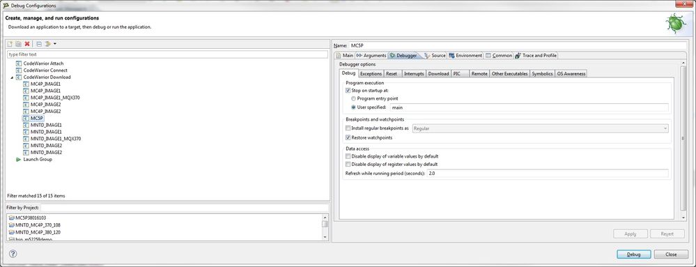

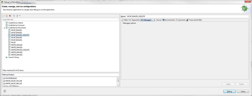

The debugger screen has gone missing on another project again. It is very much project specific.
I have gone Run > debug config and under "Codewarrior Download" I have 12 options for 2 projects. One entire project has the "Debugger" screen empty, the other is there an working normally. starting with -clean does nothing to fix the project specific problem...
Half the problem is the entire project is fully customised (like a days work), they are all configured with custom paths, linkers, output files not to mention the files and build process etc etc etc, it is not a quick job to fix this, and there is so much risk that I can make a mistake. How do I FORCE it to work? How do I get it to recognise the debugger interface???
I am in the middle of a production release to a couple of thousand field units which engineers and staff are waiting on...
I guess I will be rebuilding everything from scratch as I cant wait for a response.
update: I have been copying Run/Debug settings recently using "Duplicate", renaming things, and applying things to all projects or individual project. One of these is causing the problem! Something you can do when updating all, or each project is corrupting something to do what that screen.

I had restarted, and reboot my computer. I ended up importing about a dozen projects, then, suddenly  I imported an old project and it all started working...
Recursive paths in that section is only for the compiler, so pretty useless. You have to add everything into the actual paths otherwise nothing else will work in eclipse.
