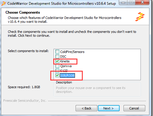

Hello Timothy,
During install CW, please select the device you want to development ,
I think maybe you haven't choose "Kinetis", so please reinstall it .
Hope it helps
