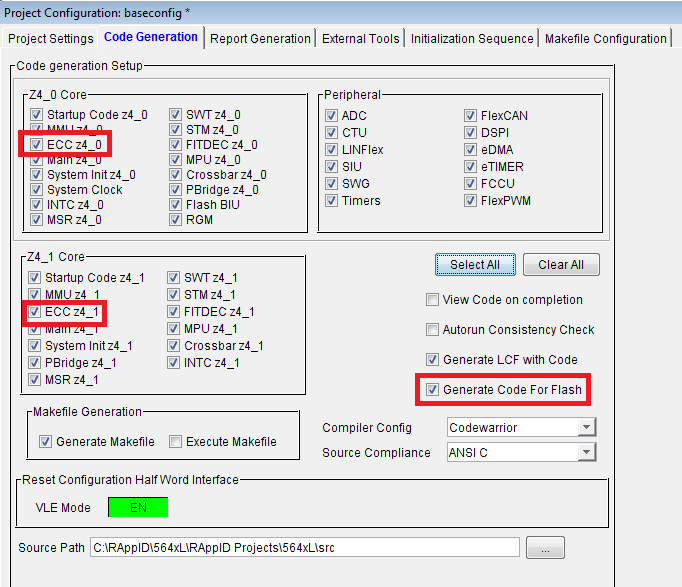

Hello everybody!
I am working on the MPC5643L using the tools RAPPID and CW10.5.
(development environment: XPC56xx EVB Motherboard Rev. C with XPC563xL 144LQFP MINI-MODULE equipped with µC PPC5643L)
I have a problem with the use of global variables in my project. Running in debugger works fine. Stop debugging and do a power reset the µC does not start running.
It seems the µC starts working doing e. g. the initilazation of the ports for LEDs and then corrupts.
Here is my source code: (µC is configured for DPM)

If i just do "dummy1 = 0x12345678;" in while(1) (dummy2 commented out) it works fine with or without debugger.
if i define dummy1&2 as uint8 or unit16 it works fine with or without debugger.
Does anybody know this behaviour and can help me?

stanish
Hello Florian,
I've noticed the startup code (crt0_p0.s) does not include RAM ECC initialization routine.
If this routine is missing in debug - you don't see any problem since debugger script initializes the SRAM. But after a power on reset with no debugger connected an ECC exception might occur.

stanish
Florian,
Please ignore my post with SRAM init code. RAppID init will generate SRAM initialization code if the correct option (ECC) is checked.
Enable this ECC RappID option for all the cores you are using. Also make sure "Generate Code For Flash" option is enabled. and regenerate the code.
If it does not help. Can you please also attach RappID init. project file (e.g. to the Service Request you've created)?
Thanks!
Stan
10,100 Views
flofa
Hey Stan,
thats it. This was the right hint.
I have tested it on both my LSM and DPM project and it works fine. :smileyhappy:
Just simple if you now what to do. :smileywink:
Florian
