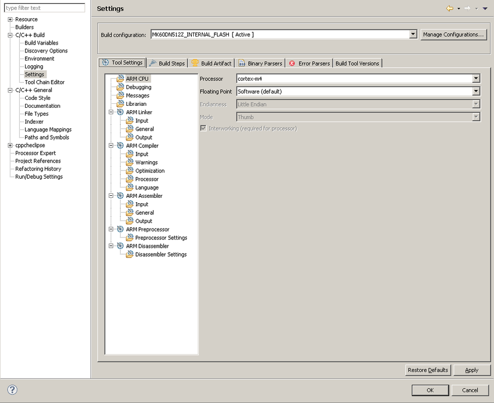

How to print code size information on CW10.2?
I have found this tutorial but in my codewarrior there is no Additional Tool tab here. How to turn it on?
http://mcuoneclipse.wordpress.com/2012/09/24/code-size-information-with-gcc-for-armkinetis/
My CodeWarrior :

Hello
   The blog post is talking about CodeWarrior MCU V10.3 for this feature.
    I think you need to upgrade to that version of the tool to see the Additional Tools settings page
