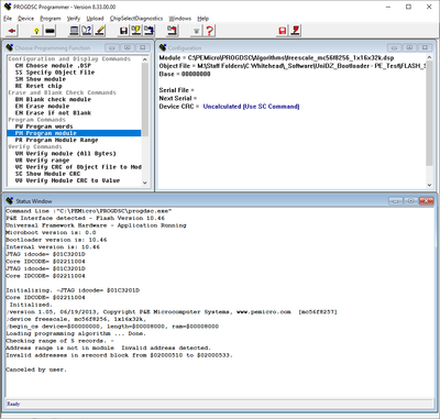

Things have moved on. I've sucessfully compiled and linked some static bootloader code for the MC56F8256 using the Eclipse 11.1 IDE. The new problem is that when I try to program my hardware the programmer complains about an invalid srecord block from $02000510 to $02000533.
I think the problem stems from the linker command file I used for the project, see attached zip file. Can anyone give me a pointer on what I should do? How should I modify the LCF for my project? Is there an LCF for the MC56F8256 bootloader in the 11.1 IDE?
