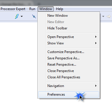

I use MQX 4.2 for my application. When the MQX-projects and the project for my application are open, I get hundreds of errors when I build all. But when I close my application project, build then the MQX projects, open afterwards my application project again, the build works without errors. Is there a possibility to change the build order for the projects I have opened?

In order to modify the build order of the projects in your workspace please follow these steps:
- Go to menu Window > Preferences
- Click on General > Workspace > Build Order
- Uncheck the option "Use default build order"
- Now you should be able to modify the build order of the projects, once you finish click on "Apply" then "OK"
Hope it helps!

Thanks a lot! It works now.
