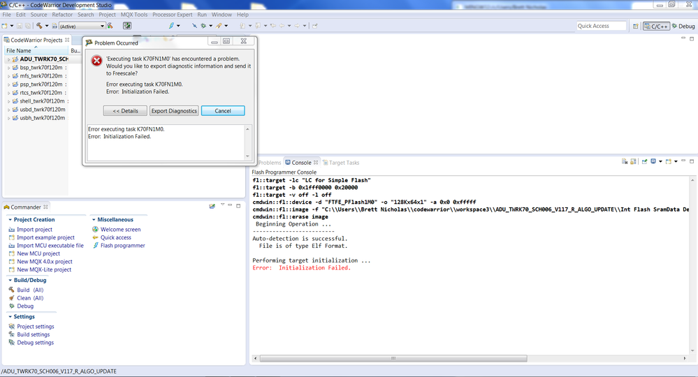

All of a sudden I started to get a very odd error when trying to flash our project to a K70f120m. The project builds fine, but I get the error any time I try to flash or debug.

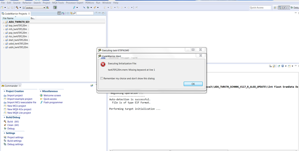

First, this warning alert appears I(NOTE: I also received the same error, but pertaining to the .xml flash config file). 50730_50730.PNGerror1.PNG
When I click OK, it tries to flash target and the below error occurs.
If this is some sort of environment variable or file path error (this project is under version control and code is edited by 3 people on 3 different computers), the error messages are not specific enough for me to figure out which variable isn't set properly and fix.
Attached is a diagnostic report. Any and all help would be much appreciated, as this is a time critical project!

from the first screenshot, it shows the problem is in twrk70f120m.mem file.
I just searched this file under CW10.6.4 and MQX4.2 install but i didn't find it.
the default MQX twrk70f120m project use memory configuration file K70FN1M0.mem. see attached video for where to set it.

Thanks, I ended up deleting then reinstalling the MQX files, and it started working
