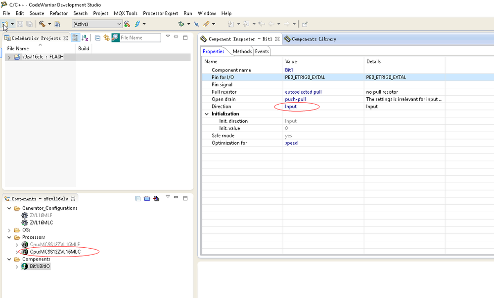

Hello!
I use S9ZVL16CLC(32pin) MCU in PE in CW 11.0 and my problem is I can't set pin as any mode related to input, even the normal input mode. But I can set as output mode in the relevant pin successfully in S9ZVL16CLC. And I can set input and output mode normally in S9ZVL32VLF(48pin) on the TRK-S12ZVL board. It's so werid.
Does anyone know the reason?
Thanks for anyone replying.

Hello Li Yinwei ,
Could you please take a whole screenshot about the BitIO component configuration and the faild inforamtion.
I test on my side ,it can work well :

elder_atom
Hi Alice_Yang
      Thanks for  your replying. There is no error information appeared during my building and debugging process. I set the pin mode as input and input capture. But I just find my board can't catch any rising edge or failing edge. It's weird.

Hello Li Yinwei,
Please check whether the pin you connect to input is right.
And how do you identify " board can't catch any rising edge or failing edge".
You can aslo share your proejct , I will check it on my side.
Hope it helps,
Alice

elder_atom
Hi Alice_Yang !
Can you provide me a valid example that set TOC0_2 pin in S9ZVL16CLC ( 32 Pin ) as input capture mode so that I can check whether the problems are in my hardware or my software. Thanks a lot.

Hello Li Yinwei,
Sorry I haven't one board for this chip,  could you please use the "Typical Usage " to have a try :
I think there is no errro with code ,if still can't work , recommend you check hardware .
You can talk about the hardware quesiton on this thread :
https://community.nxp.com/community/s32/16-bit?tid=communitys32
Alice

elder_atom
Hi Alice_Yang
      Thank you for your replying! " board can't catch any rising edge or failing edge" means every pin that have input  capture function can't catch the effective edge.
Please help me check whether the TOC0 pin is OK in Capture mode.Thanks a lot.
