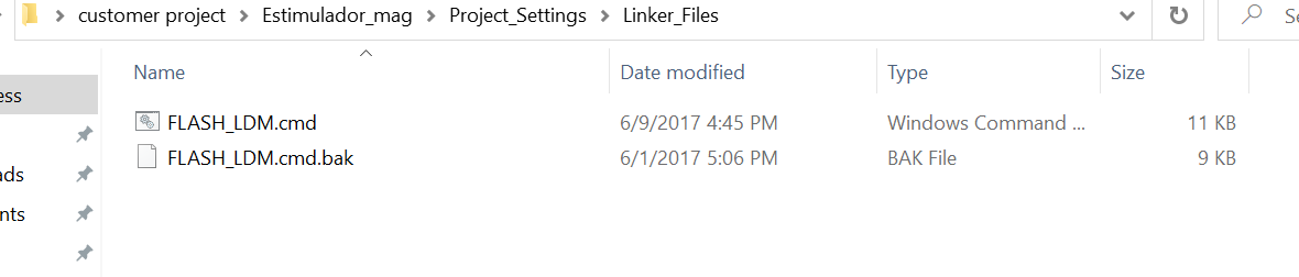

I finally got to clean the project with FLASH_LDM, ¿why it does not work with FLASH_SDM?
On the other hand, once cleaned, I try to build it into the MC56F84789. These errors occur. How can I connect and communicate with the micro?
7,402件の閲覧回数
ZhangJennie
Your project doesn't include FLASH_SDM linker file. the related folder has FLASH_LDM file only.
please check the original project owner to provide SDM linker file for building FLASH_SDM configuration.
